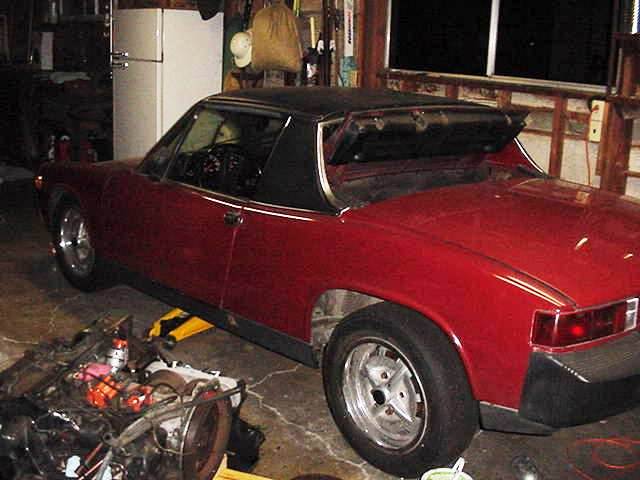

rhodyguy   the engine is going in this car. k   Sep 16 2005, 09:27 PM

rhodyguy   5.5x15. 195/60 tires. tons of room. the chrome tri...   Sep 16 2005, 09:53 PM

Aaron Cox   nice!!! when did you get that red car...   Sep 17 2005, 09:49 PM
rhodyguy   don't forget the flywheel o-ring. DOH!...   Sep 18 2005, 07:47 AM
rhodyguy   couple of years ago aaron h...   Sep 18 2005, 08:30 AM
