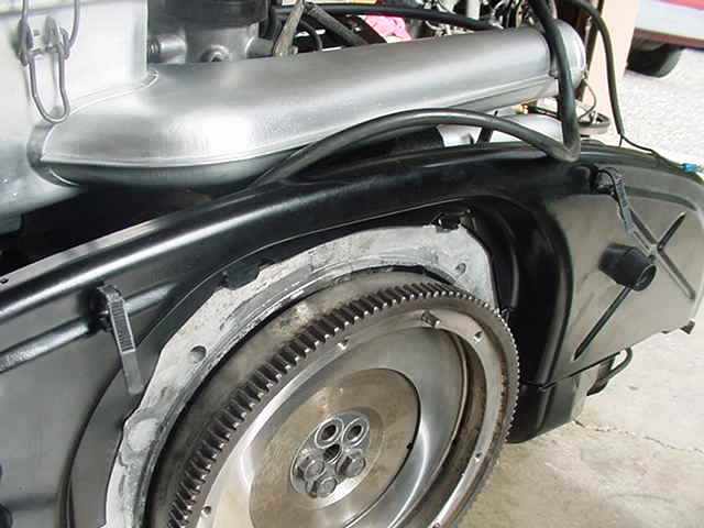

rhodyguy   trivial nonsense. salvaged correct zip ties. k   Sep 17 2005, 08:43 PM
sixnotfour   Hey hey dude you are missing 2 flywheel bolts. bo...   Sep 17 2005, 08:57 PM

rhodyguy   don't forget the flywheel o-ring. DOH!...   Sep 18 2005, 07:47 AM
