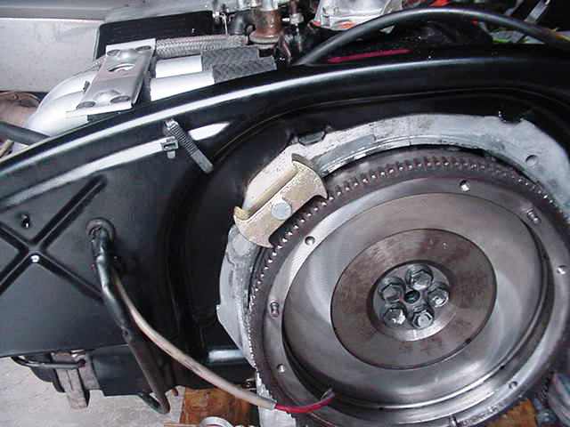

rhodyguy   will adjust the valves, temp put on the flywheel, ...   Sep 14 2005, 08:30 AM

rhodyguy   busy day. adj valves, r&r front inboard engine mou...   Sep 14 2005, 08:04 PM

rhodyguy   still a few stray lines to install. new fan belt. ...   Sep 16 2005, 08:44 PM
rhodyguy   Cerama-Chrome. i put the gear lube in the trans to...   Sep 16 2005, 08:47 PM
rhodyguy   i should be mating the engine and the trans on sa...   Sep 16 2005, 08:49 PM

sixnotfour   Hey hey dude you are missing 2 flywheel bolts. bo...   Sep 17 2005, 08:57 PM

rhodyguy   don't forget the flywheel o-ring. DOH!...   Sep 18 2005, 07:47 AM
