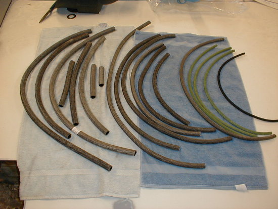

You will never, never , ever get me to tell you where I purchased these (IMG:http://www.914world.com/bbs2/html/emoticons/rolleyes.gif)
But I did measure and record each hose and where it goes. I will post a VH diagram for 1.7's when I get some time so no one has to do the unthinkable like I did.
