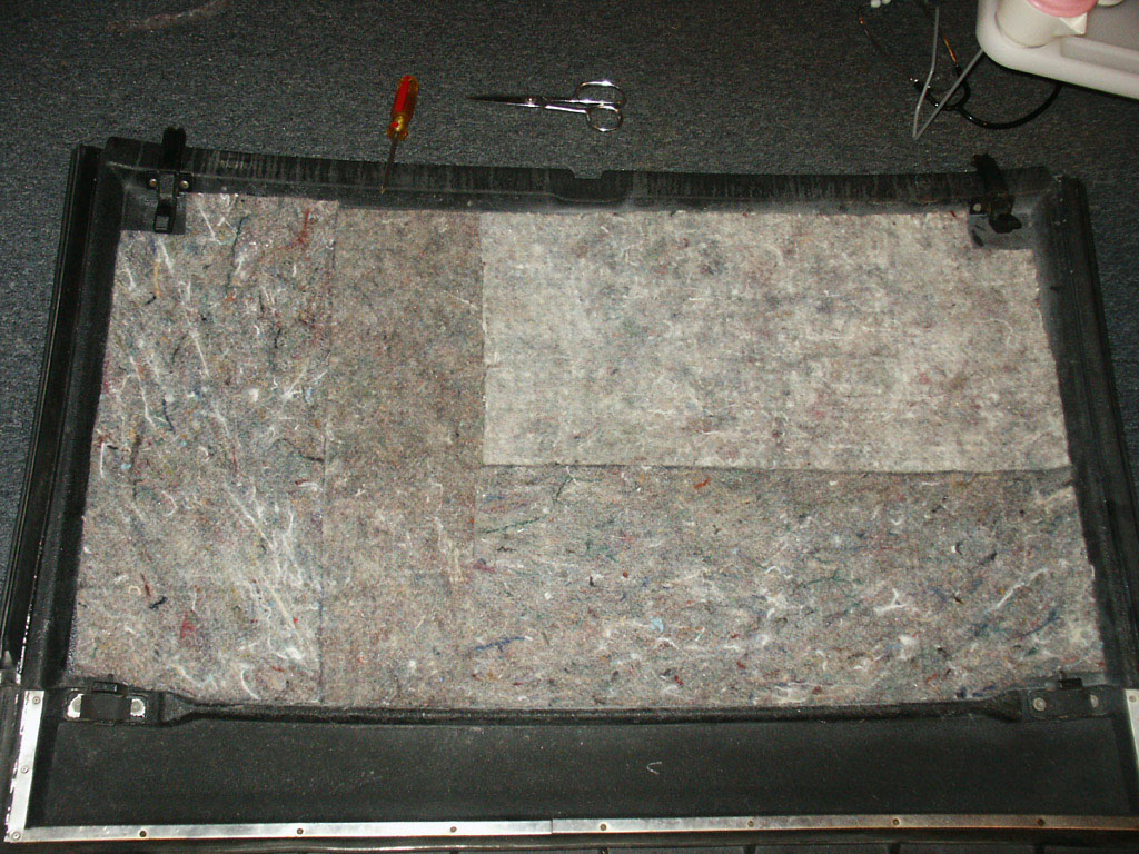

I'm tired of my top reverberating noise like a concert hall..
So, I dug out my old sound insulation for my beetle... clean it off, vacuum it and grab the 3M spray adhesive... I also got a sheet of cloth (polyester??) that's got some 3M super-adhesive backing. It's white but can be colored easily.
I'll see how it sounds in comparison tomorrow on the freeway.

Step 3:
Have a beir. (IMG:http://www.914world.com/bbs2/html/emoticons/beer.gif)
(IMG:http://photos1.blogger.com/img/182/1011/1024/newcastlebrown%20re.jpg)
Step 4:
Assembly, cutting, gluing.
- Measure and cut your insulation to fit into the targa top main section. Don't worry about the small rectangular section near the back/bottom. That covers the targa bar and isn't inside the cab.
