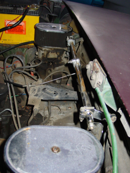

So I got me a second 914, to drive while I finish restoring the "keeper". But it has dual webber 40's with issues.. It doesn't like to idle, and if I spray carb cleaner into some of the venturies it idles better, others not. Should I just pull them and rebuild them? Turning the adjustment screws doesn't seem to make much difference.
I'm trying to acertain whether or not it has the stock cam, if it does I'll probably go back to fuel injection.

QUOTE (Joseph Mills @ Oct 2 2005, 10:33 PM)
Sounds like your linkage may need to be upgraded. Do you have a pic of it?
Linkage pics!

Aaron Cox   CB linkage kit. its the bomb dot com   Oct 3 2005, 09:12 PM

mikelsr   Are there additional springs on the throttle linka...   Oct 4 2005, 10:58 AM

bd1308   that angle will give you most of your problems.......   Oct 4 2005, 11:46 AM
mikelsr   Are you talking about the return spring on the car...   Oct 4 2005, 03:05 PM

rhodyguy   what i don't care for on the cb linkage is the...   Oct 5 2005, 08:18 AM
