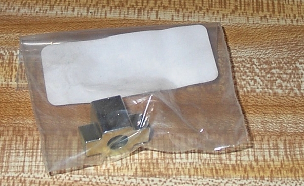

so i was laying under the car today looking for the clutch connection to the tranny.
found it (IMG:http://www.914world.com/bbs2/html/emoticons/biggrin.gif) i found the pully thing that the clutch cable goes around then i found where the cable should attach to and its not... (IMG:http://www.914world.com/bbs2/html/emoticons/sad.gif) so i can see the rod that comes out of the passenger of the tranny and there is a fork on the end and it has a slot cut in it. i can see that there should be some piece of metal the the clutch cable runs through and then there should be a bolt on the end im guessing. so does anyone know what the missing piece is and where i could pick one up? i have attached a picture of the fork coming out of the tranny one more thing that kinda worries me... when i pull on the lever coming out of the tranny it dosent budge should it? i made sure it was out of gear first, i dont know if that would make any difference so...is that normal? sorry the picture is such low quality its the best i could do. the rod/fork thing im talking about is pretty much in the center of the frame (IMG:http://www.geocities.com/shaggy_nine14/img_1596.jpg) -shaggy (sorry im logged on as my dad) |

John,
Cover the shipping and I can send you the piece your missing for free. Brand new. As for your other problems whats the current status of the car. Where you driving it?? Are you in the process of rebuild the clutch etc.. Heres the piece you can have for shipping costs Attached image(s)

736conver Its a 911 part
Part#91142320503 Oct 5 2005, 07:57 PM

dmenche914 the shift fork contact point with the little winge... Oct 5 2005, 08:03 PM
Dave_Darling The 911 part works just fine. The plastic, as men... Oct 5 2005, 08:49 PM
bd1308 I used a 2 or 3 M8s and apparently what I believe ... Oct 5 2005, 08:57 PM

actually I just remembered that the thr... Oct 5 2005, 09:21 PM

bd1308 I wouldn't use locktite.....it would be a huge... Oct 5 2005, 09:39 PM

Dave_Darling M7 nuts; use two of them tightened against each ot... Oct 6 2005, 12:11 AM
Flat VW Shaggy (my boy Jim) fixed it (with your help)... Oct 6 2005, 05:53 PM![]() ![]() |
