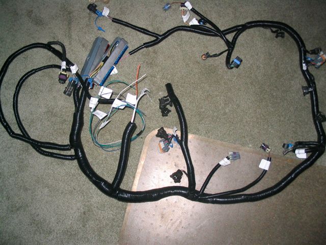

QUOTE (andys @ Oct 7 2005, 12:06 PM)
I ask, is that the LS1 Chevy harness mod's and re-programming the PCM to remove VATS, VSS, and down the pipe O2's is about $750.
Andys
Andy you can get a reprogram for a stand alone LS1 harness ECM for $75 not $750. The shop that did my reprogramming is one of the most respected tuners on the LS1 sites. He will sell you a reprogramed computer ready to go for $150 if you don't already have one.
The harness is easy to modify I bought the tools to remove the pins from the connectors and did mine myself in about 8 hrs.
Bob (IMG:http://www.914world.com/bbs2/html/emoticons/huh.gif)
