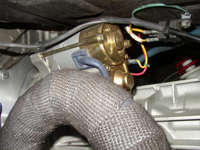

You really don't need the 'Ford relay'. You can use the small square 25A general purpose relays hanging up on blister packages at your local FLAPS for a starter solenoid relay. You can see mine connected in the upper right corner of this picture:
