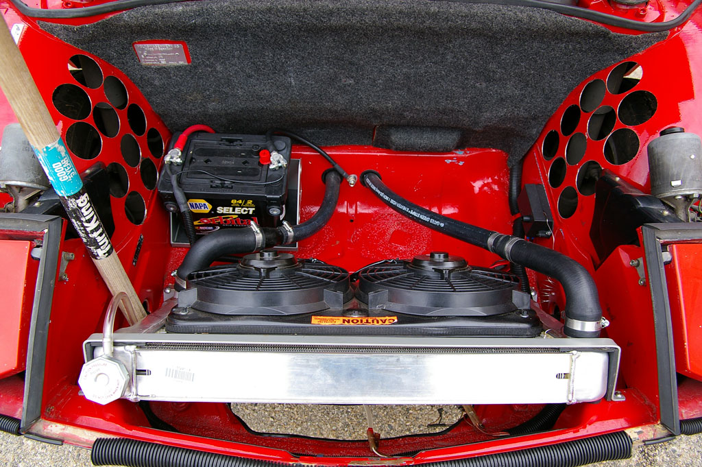

I have seen a few different ways to run hoses on a car that is using a front mount radiator.
I really have no desire to run copper piping through the cab of the car so that is out of the question.
I have also seen alot of people running the rubber hoses under the car and down the center. I am sure that it is a great way, but it scares me a bit, especicaly when speed bumps come around.
Is it possible to run the hoses through the center channel of the car?

QUOTE (marks914 @ Oct 7 2005, 09:59 AM)
I didnt know Griffin made a dual pass radiator. Was it pricey? I am interested to know how well it works.
Mark
Griffin 27 1/2 x 15 1/2 radiator with two rows of 1" tubing for $189.95 from Summit Racing. I bought the Griffin 27 1/2 x 15 1/2 radiator with two rows of 1 1/4" tubing for $259.95 from Summit. I wanted to be doubly sure I didn't have any cooling problems. (IMG:http://www.914world.com/bbs2/html/emoticons/cool_shades.gif)
