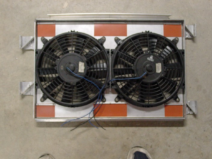

QUOTE (dakotaewing @ Oct 14 2005, 01:34 PM)
Andys - Did you get your fan set up and shroud from AFCO as well???
Your set up looks pretty clean... (IMG:http://www.914world.com/bbs2/html/emoticons/smilie_pokal.gif)
Thom
Thom,
I made the shoud. In the below pic, notice the (orange)flappers that allow additional air to pass at speed. The fans are made by Zirgo. You can buy directly from them....Don't have the site handy, but it's probably zirgo.com. For shroud and fan assemblies that you can purchase, I have some info at the office I'll post tomorrow.
Andys
