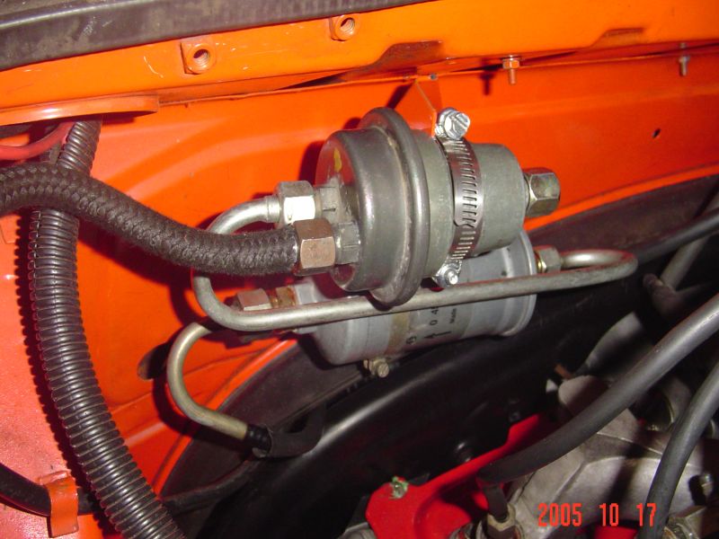

I went over to DougC's house after work today. We did some checking on his CIS system on his 2.7S motor. Nice install. The airbox was modified using AUDI parts so that the factory engine latch could be retained.
I started with the basics. Spark was there and strong. Checked the timing by taking out #1 plug and feeling for compression, then checking to make sure that the rotor was pointed at the #1 wire. No problems there.
Pulled one injector and with the key on, raised the sensor flap. Yep.. we got fuel spray.
Put the plug back in and hooked the wire up. Put the injector back in. It fires and runs for about 30 seconds then dies. I wait 30 seconds and try again. It does it again.
It was then I noticed that the metal fuel return line under the battery was plugged with a bolt... But no fuel is leaking out.... (IMG:http://www.914world.com/bbs2/html/emoticons/confused24.gif)
I look, and the accumulator is off a later car, and there are 3 fittings on it. The return line is plumbed into the back of the accumulator, and it goes no where else.
Well..... that will make the car run a bit rich!!!!!!
Doug is going to Stuart hose on Saturday to get a new line made. It was too short from the accumulator to the fuel distributor anyway.

OK, I was able to locate the correct size cap nut and so I was able to use the accumulator that I already have. Here's a pic -
Doug C
