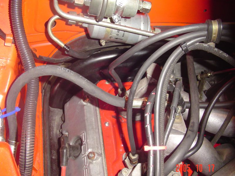

And I had a hose made up for the fuel return to the gas tank.. This was to line that I originally had going into the 3rd port on the accumulator (now capped). The new hose is the one in the picture with the blue plastic tie-band. Here's the pic..
Doug C
