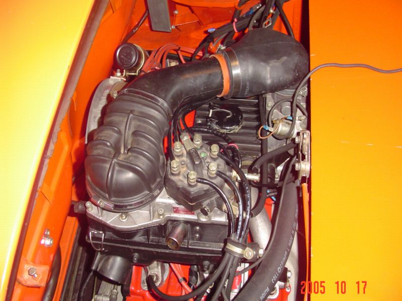

The problem is, that the car is still doing what it did when Clay was diagnosing it. The thing will start and run for a few seconds then quit. Or it will also quit if I give it any throttle input. I checked timing again yesterday and it seemed to be ok. I think it's a fuel delivery problem, but I just don't know..
Here's some pictures of the Audi airbox that is installed on my engine. Wish I could take credit because I think it's a good looking set up, and is a little less bulky looking than the stock CIS set-up BUT..it was the work of previous owners.
Doug C
