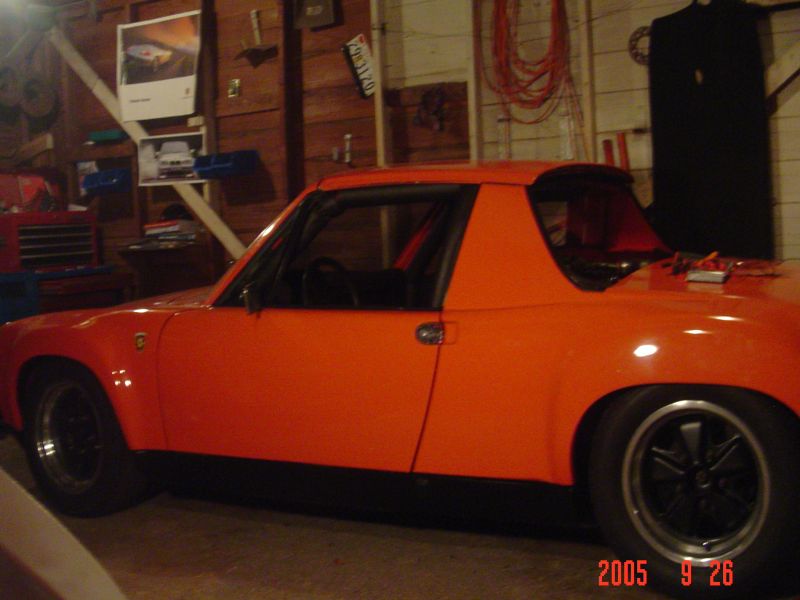

DougC
post Oct 17 2005, 09:25 AM
Posts: 949
Joined: 6-July 04
From: Dallas, TX
Member No.: 2,307
I feel so close..yet so far. Here's a pic of the car since you ask. Oh, how I hate showing people my car (IMG:http://www.914world.com/bbs2/html/emoticons/wink.gif)
Doug C
