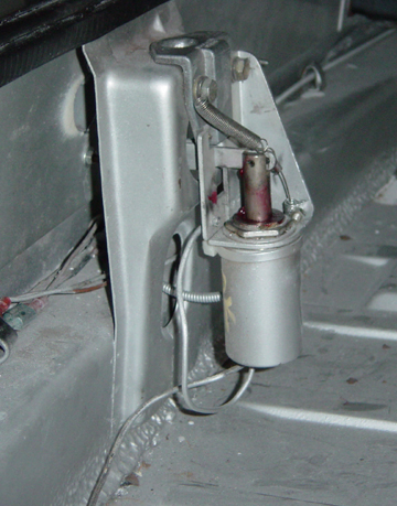

Jeffs9146
post Oct 17 2005, 06:28 PM
Ski Bum
Posts: 4,062
Joined: 10-January 03
From: Discovery Bay, Ca
Member No.: 128
Here is what it looks like with an electric solinoid. Notice the cable on the right side, thats my backup! You can drill a hole from under the trunk and use the coat hanger to pull down on the arm!
Jeff
