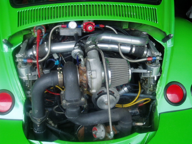

Alot of turbo talk lately. Just curious, for those who have been there/done that, what turbo did you pick, why, and if your project is on the road, how do you like it?

turbo on a type4 works well if you know how much power up need for the street .10 psi is a good 160-205hp this a hand full for a day to day day but 20psi of boost is a hole new ball of wax .you all think more is better but it is not for road use i have done the 20+ psi thing and it gets old quick trying to keep the car on the road .the upgrade you will have to do on your brakes the bigger wheels and rubber you will need and so on .if you are going to build a dyno queen go for it .but remember all that power come with a price tag .
