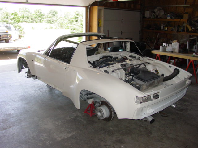

Greetings all you 914 fans out there! Here's a pic of my 74 Sheridan bodied 500 HP LS6 powered 914. The entire conversion has been running since 2002. It started out an LS1 425 HP motor and then I sold than motor and threw in an LS6 with all forged internals. I'm curious what Nitrous might do for me...but I'm certain the 915 trans would blow to smithereens in a second. I've already done that once before. I am considering a G50/50 but the expense is out of this world!
SPECS:
* Modified Sheridan body w/ 996 intakes, opened up front intake and AIR rear trunk lid
* 930 turbo front suspension & rear 930 turbo brakes & emergency brakes.
* full 8 point cage
* Sparco roadster carbon fibre seats
* Schroth 6 point harnesses
* 500 HP built 2004 LS6 motor
* Custom leather "911" 5 guage dash
* 915 tranaxle w/ LSD and tall 32:20 5th gear, trans pump/cooler(FOR SALE ON E-BAY)
* 993 turbo hollow spoke wheels w/ Pilot sports
* custom ram air feeding from side 996 intakes
* custom tunnel through hood (GT 40 style)
* much more...etc
