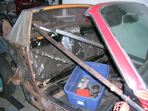

This is what I have done, but I have a serious hell hole and lower pass long repair (the lower left corner of the left long is rotted through along with the std hell hole rot, I think the PO let the pass. floorboard fill with water, rot away, and then they replaced the rotted floor with a new one without fixing the long). I have a brace with a turnbuckle going from the upper pass. seat belt mount to the upper pass door mount, and another brace with a turnbuckle going from the lower driver door mount to (essentially) the upper pass seat belt mount. Without both my targa bar was not aligned with my windshield.
