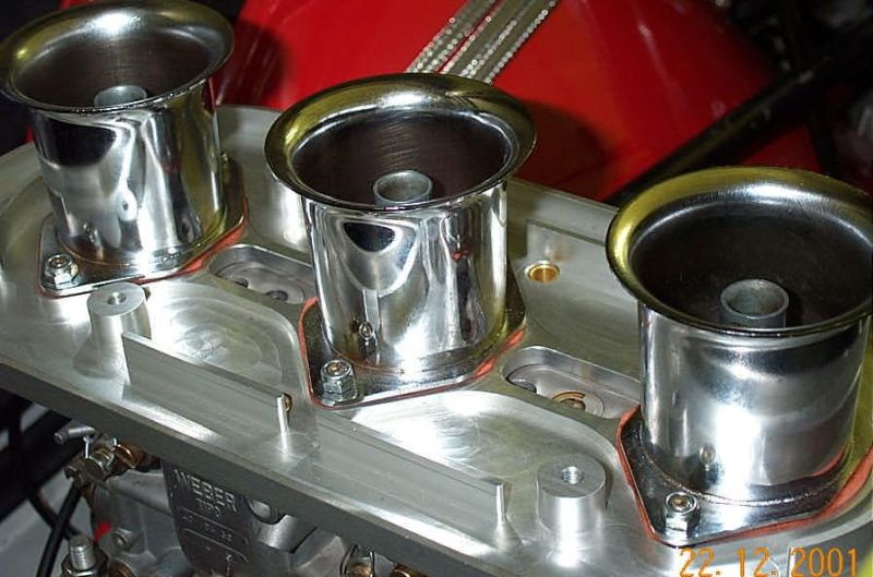

Oh boy, I get to post my only artsy pic....that I have taken.
I went out and measured. The height (lenght) of these puppies is 4.5 inches. Bore is a bit less (eyeball) than .5 in.

J P Stein   Oh boy, I get to post my only artsy pic....that I ...   Nov 3 2005, 06:01 PM
trekkor   that picture makes me happy http...   Nov 3 2005, 06:12 PM
Aaron Cox   gawd - what did those milled aircleaner bases set ...   Nov 3 2005, 06:14 PM
J P Stein   I've heard a few things about "why"....interne...   Nov 3 2005, 06:21 PM
J P Stein   ...   Nov 3 2005, 06:24 PM
Aaron Cox   whatchu runnin now JP? ITG style? wonder if th...   Nov 3 2005, 06:27 PM
brant   Its the reversion issue and my 4K stumble that has...   Nov 3 2005, 06:37 PM
J P Stein     Nov 3 2005, 06:49 PM
Aaron Cox   what is reversion? im a newb ...   Nov 3 2005, 07:04 PM
J P Stein   The only place I've actually seen this was on ...   Nov 3 2005, 07:07 PM
