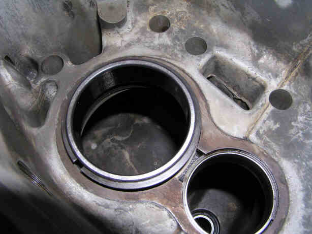

Seating the race. I used a piece of PVC pipe about the same diameter to drive the race in. I tapped very lightly, slow going. The case wouldn't fit in the oven and the wife was on a terror last night so I couldn't heat it. (IMG:http://www.914world.com/bbs2/html/emoticons/mad.gif)

DNHunt   Seating the race. I used a piece of PVC pipe about...   Nov 5 2005, 08:50 AM
DNHunt   Here is the race seated and the second snap ring i...   Nov 5 2005, 08:59 AM
