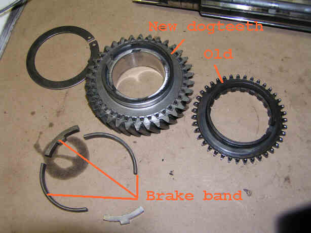

Here's the new dogteeth installed on the gear. 2nd gets a new syncro, new dogteeth and the 4th - 5th slider. 3rd gets a new syncro.

DNHunt   Onto the gear stack. I needed to replace dogteeth ...   Nov 5 2005, 09:13 AM

DNHunt   Here's the new dogteeth installed on the gear....   Nov 5 2005, 09:21 AM
DNHunt   I put the brake band stops (I can't remember i...   Nov 5 2005, 09:27 AM
DNHunt   Brake bands installed. There are 2 on 2nd through ...   Nov 5 2005, 09:31 AM
