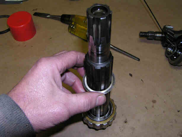

DNHunt   Onto the pinion shaft. Just got back from a soccer...   Nov 5 2005, 04:20 PM
DNHunt   Next come the shims that help set pinion depth.   Nov 5 2005, 04:24 PM
DNHunt   I had 3 shims in this box. I think there can be di...   Nov 5 2005, 04:26 PM
DNHunt   After that washer is 5th gear. One of the hard thi...   Nov 5 2005, 04:31 PM
DNHunt   There is a ridge on one side of 4th and 5th gear t...   Nov 5 2005, 04:36 PM
DNHunt   4th gear with the ridge down facing the spacing co...   Nov 5 2005, 04:49 PM
DNHunt   Another washer   Nov 5 2005, 04:50 PM
DNHunt   Next comes the race for the roller bearing for the...   Nov 5 2005, 04:52 PM
DNHunt   Roller bearing for 3rd gear goes on next. It just ...   Nov 5 2005, 08:30 PM
DNHunt   Here's the roller bearing on the race ready to...   Nov 5 2005, 09:05 PM
DNHunt   3rd gear assembly goes over the race and roller be...   Nov 5 2005, 09:07 PM
DNHunt   Next is the slider hub for the 2nd and 3rd slider....   Nov 5 2005, 09:09 PM
DNHunt   2nd, 3rd slider fits on its hub. You can't mis...   Nov 5 2005, 09:10 PM
DNHunt   Next the 2nd gear race, roller bearing and gear as...   Nov 5 2005, 09:13 PM
DNHunt   Another cone washer goes on next. You have to keep...   Nov 5 2005, 09:16 PM
DNHunt   Finally, the race for the ball bearing in the inte...   Nov 5 2005, 09:20 PM
DNHunt   The finished pinion shaft assembly   Nov 5 2005, 09:40 PM
