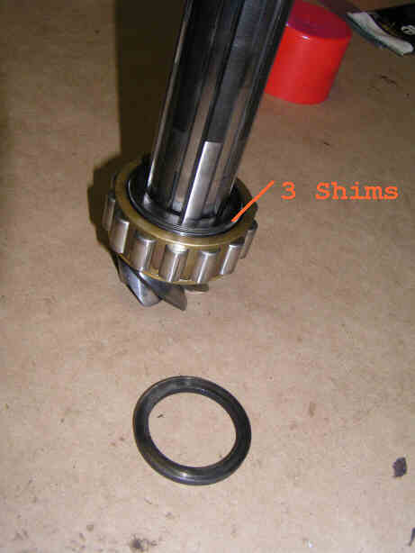

I had 3 shims in this box. I think there can be different numbers unlike the endplay shims on a type 4. The washer that goes next is on the bench

DNHunt   Next come the shims that help set pinion depth.   Nov 5 2005, 04:24 PM
DNHunt   I had 3 shims in this box. I think there can be di...   Nov 5 2005, 04:26 PM
