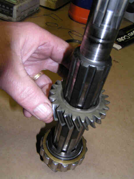

DNHunt   After that washer is 5th gear. One of the hard thi...   Nov 5 2005, 04:31 PM
DNHunt   There is a ridge on one side of 4th and 5th gear t...   Nov 5 2005, 04:36 PM
DNHunt   4th gear with the ridge down facing the spacing co...   Nov 5 2005, 04:49 PM
