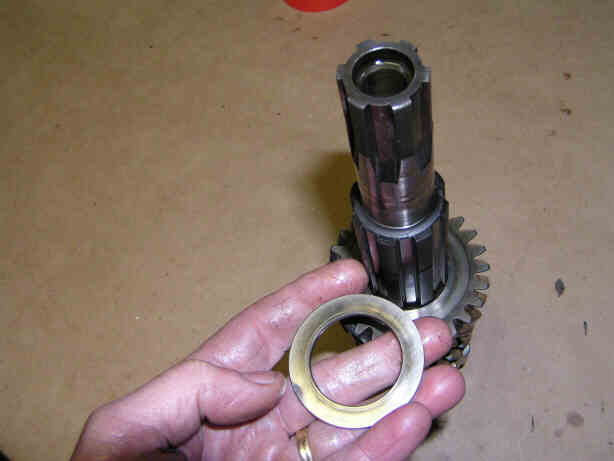

DNHunt   Onto the pinion shaft. Just got back from a soccer...   Nov 5 2005, 04:20 PM
DNHunt   Next come the shims that help set pinion depth.   Nov 5 2005, 04:24 PM
DNHunt   I had 3 shims in this box. I think there can be di...   Nov 5 2005, 04:26 PM

DNHunt   Another washer   Nov 5 2005, 04:50 PM
