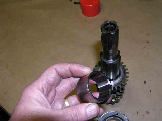

DNHunt   Roller bearing for 3rd gear goes on next. It just ...   Nov 5 2005, 08:30 PM
DNHunt   Here's the roller bearing on the race ready to...   Nov 5 2005, 09:05 PM
