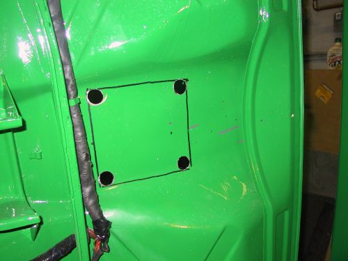

I know this is a little bit controversial (sp?), but I have noted that several GT cars seemed to have had this hole, and it certainly made life easier in my previous /4 conversion, so I decided to put an inspection port in my firewall. See the /6 restoration I'm doing:

First, I cut a cardboard template for the hole:

Then I drilled a 7/8 th inch hole in each corner, using a bi-metal hole saw.

michel richard   I then cut out the hole, using a 4 inch cutoff bla...   Nov 5 2005, 07:09 PM
michel richard   On the engine side, I spot-welded some 6 mm fender...   Nov 5 2005, 07:09 PM
michel richard   And I made the closing piece of thick gauge stainl...   Nov 5 2005, 07:12 PM
