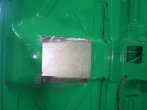

I know this is a little bit controversial (sp?), but I have noted that several GT cars seemed to have had this hole, and it certainly made life easier in my previous /4 conversion, so I decided to put an inspection port in my firewall. See the /6 restoration I'm doing:
http://www.914world.com/bbs2/index.php?act=...f=2&t=34896&hl=
First, I cut a cardboard template for the hole:
michel richard
post Nov 5 2005, 07:12 PM
Posts: 1,291
Joined: 22-July 03
From: Longueuil, Québec
Member No.: 936
And I made the closing piece of thick gauge stainless steel. It may be that there is an advantage to using stainless, because it does not conduct heat as much as other steels, but I just used that because it's what I had.
Total time, probably about an hour. It helps massively that the engine was out, and the tub on a rotisserie.
Hope this helps someone.
Cheers.

736conver   Looks good. I have been debating if i want to go ...   Nov 5 2005, 07:14 PM
michel richard   I'm not sure it's really necessary, but if...   Nov 5 2005, 07:50 PM
J P Stein   You're doomed.....DOOMED TO A FIRERY DEATH.......   Nov 5 2005, 09:06 PM
michel richard   J P, Please don't choke to death ! It ca...   Nov 5 2005, 11:11 PM
thesey914   Another fingernail trimmer, I can see the wisdom i...   Nov 6 2005, 03:57 AM
joea9146   I do not regret having one also...
