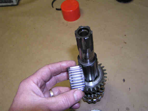

Roller bearing for 3rd gear goes on next. It just slips over the race

DNHunt   Roller bearing for 3rd gear goes on next. It just ...   Nov 5 2005, 08:30 PM
