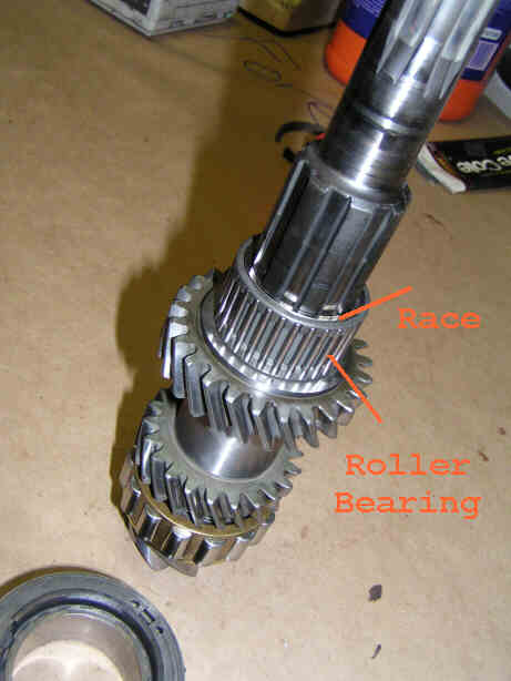

Here's the roller bearing on the race ready to install the 3rd gear assembly (gear, brake band and blocks, dogteeth, syncro, and snap ring). All of the gears go on the shafts like this.

DNHunt   Roller bearing for 3rd gear goes on next. It just ...   Nov 5 2005, 08:30 PM
DNHunt   Here's the roller bearing on the race ready to...   Nov 5 2005, 09:05 PM
DNHunt   3rd gear assembly goes over the race and roller be...   Nov 5 2005, 09:07 PM
