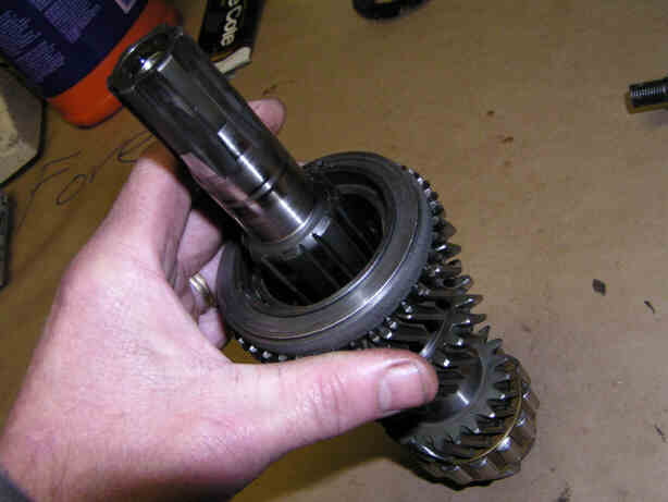

3rd gear assembly goes over the race and roller bearing with the dogteeth and snap ring up.

DNHunt   3rd gear assembly goes over the race and roller be...   Nov 5 2005, 09:07 PM
