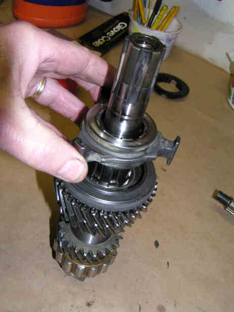

From: Gig Harbor, WA
Member No.: 598
Next is the slider hub for the 2nd and 3rd slider. Don't worry about which way it goes. There is no top or bottom so ram it home. (IMG:http://www.914world.com/bbs2/html/emoticons/sheeplove.gif)

DNHunt   Next is the slider hub for the 2nd and 3rd slider....   Nov 5 2005, 09:09 PM
DNHunt   2nd, 3rd slider fits on its hub. You can't mis...   Nov 5 2005, 09:10 PM
