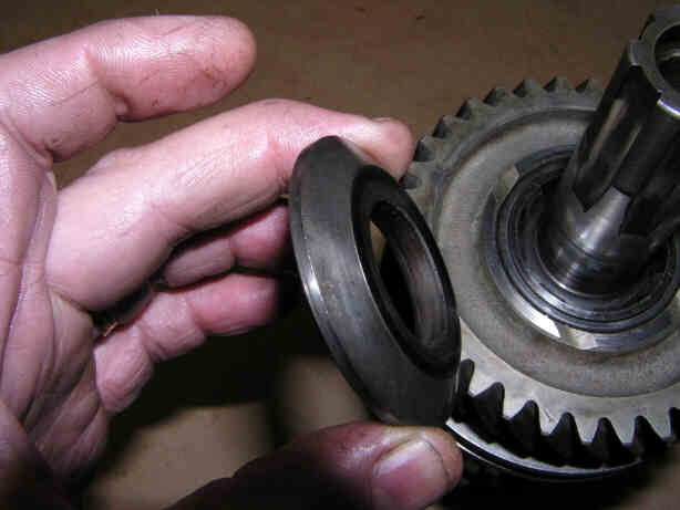

Member No.: 598
Another cone washer goes on next. You have to keep them in order cause they are all just a little different. 2nd gear is on the pinion shaft with the dogteeth pointed toward the slider (in this case down away from the camera).
