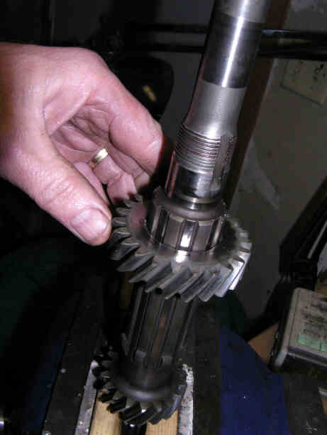

Now I turned the shaft over so i was putting parts on the long end of the drive shaft. 3rd gear next

DNHunt   Time to assemble the drive shaft. 2nd gear on the ...   Nov 6 2005, 06:12 AM
DNHunt   Now I turned the shaft over so i was putting parts...   Nov 6 2005, 06:14 AM
