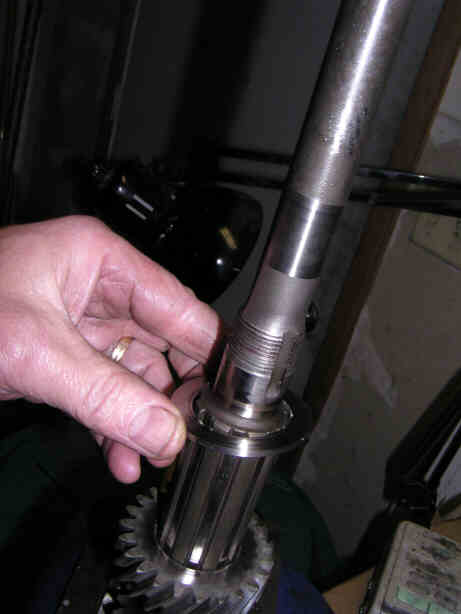

DNHunt   4th, 5th slider hub. There is no right or wrong si...   Nov 6 2005, 06:23 AM
DNHunt   4th, 5th slider. I swapped this slider with the 2n...   Nov 6 2005, 06:31 AM

sj914   4th and 5th gear are in the wrong order? How did y...   Nov 6 2005, 06:46 AM
DNHunt   You are RiIGHT. It won't go in the intermediat...   Nov 6 2005, 07:01 AM
