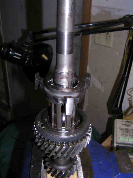

DNHunt   Here's the beginning of the one mistake I made...   Nov 6 2005, 06:20 AM
DNHunt   4th, 5th slider hub. There is no right or wrong si...   Nov 6 2005, 06:23 AM
DNHunt   4th, 5th slider. I swapped this slider with the 2n...   Nov 6 2005, 06:31 AM
DNHunt   I'm still continuing in my ignorance. 5th gear...   Nov 6 2005, 06:33 AM
DNHunt   Cone washer   Nov 6 2005, 06:34 AM
DNHunt   Next goes the smaller roller bearing and a locking...   Nov 6 2005, 06:37 AM
DNHunt   Tighten the nut down to 80 lbs and bend up 1 edge ...   Nov 6 2005, 06:40 AM
sj914   4th and 5th gear are in the wrong order? How did y...   Nov 6 2005, 06:46 AM
DNHunt   You are RiIGHT. It won't go in the intermediat...   Nov 6 2005, 07:01 AM
