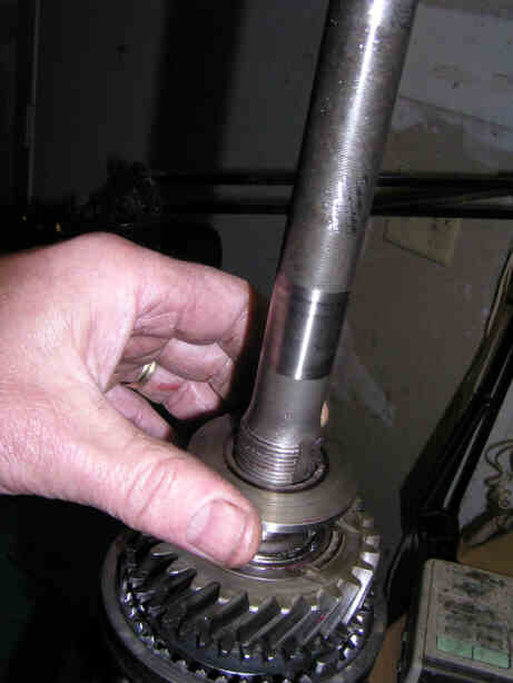

Cone washer

DNHunt   Another cone washer goes on next. You have to keep...   Nov 5 2005, 09:16 PM

DNHunt   Cone washer   Nov 6 2005, 06:34 AM
