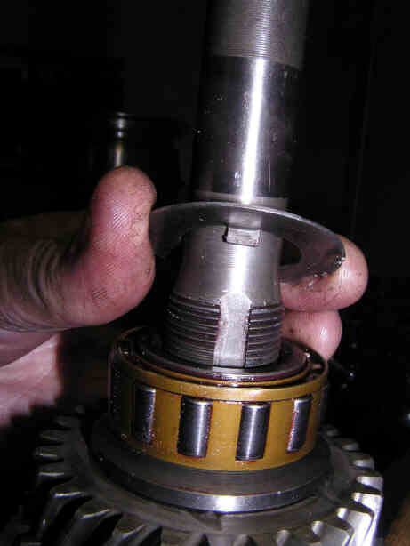

Next goes the smaller roller bearing and a locking plate. The tab goes in the slot pointed down to go under the bearing.

DNHunt   Next goes the smaller roller bearing and a locking...   Nov 6 2005, 06:37 AM
DNHunt   Tighten the nut down to 80 lbs and bend up 1 edge ...   Nov 6 2005, 06:40 AM
