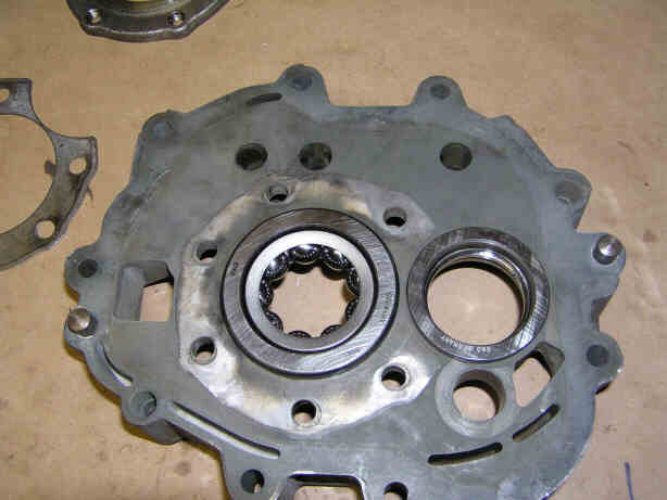

DNHunt   Ah, the intermediate plate. I installed the bearin...   Nov 6 2005, 07:03 AM
