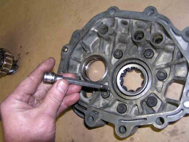

Here is another use for the CV joint tool. 8mm 12point.

DNHunt   Ah, the intermediate plate. I installed the bearin...   Nov 6 2005, 07:03 AM
DNHunt   Next comes the spacer that goes under the bearing ...   Nov 6 2005, 07:05 AM
DNHunt   The bearing retainer plate   Nov 6 2005, 07:06 AM
DNHunt   Here is another use for the CV joint tool. 8mm 12p...   Nov 6 2005, 07:07 AM
DNHunt   Torqued to 15-17 lb ft. I had a heck of a time fig...   Nov 6 2005, 07:08 AM
