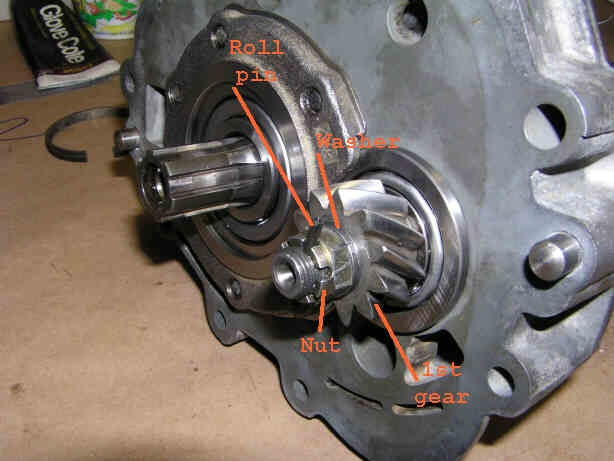

DNHunt
post Nov 6 2005, 07:48 AM
914 Wizard? No way. I got too much to learn.
Posts: 4,099
Joined: 21-April 03
From: Gig Harbor, WA
Member No.: 598
1st gear on the drive shaft is the gear then a washer, a castle nut secured with a roll pin. The flat surface of the gear faces away from the bearing.

DNHunt   1st gear on the drive shaft is the gear then a was...   Nov 6 2005, 07:48 AM
