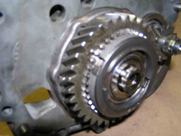

DNHunt   1st gear on the drive shaft is the gear then a was...   Nov 6 2005, 07:48 AM
DNHunt   The pinion shaft ready for the 1st gear assembly   Nov 6 2005, 07:49 AM
DNHunt   A washer goes on the pinion shaft first   Nov 6 2005, 08:02 AM
DNHunt   Just like the other gear assemblies a race goes on...   Nov 6 2005, 08:03 AM
DNHunt   Then the roller bearing   Nov 6 2005, 08:06 AM
DNHunt   Then the 1st gear assembly. Sorry about the fuzzy ...   Nov 6 2005, 08:07 AM
DNHunt   Next is the slider hub.   Nov 6 2005, 08:09 AM
DNHunt   I got this slider used and it is in really good sh...   Nov 6 2005, 08:12 AM
DNHunt   The slider goes on with the teeth facing the first...   Nov 6 2005, 08:13 AM
