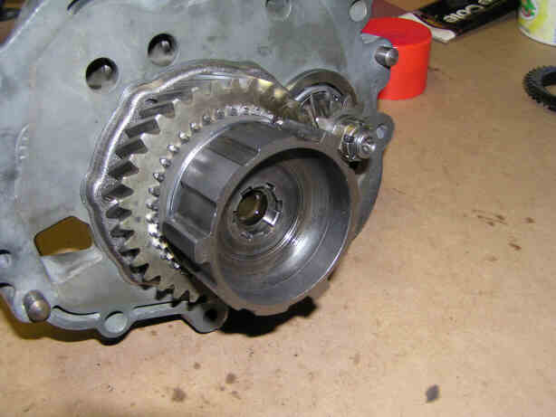

DNHunt   Next is the slider hub.   Nov 6 2005, 08:09 AM
DNHunt   I got this slider used and it is in really good sh...   Nov 6 2005, 08:12 AM
DNHunt   The slider goes on with the teeth facing the first...   Nov 6 2005, 08:13 AM
