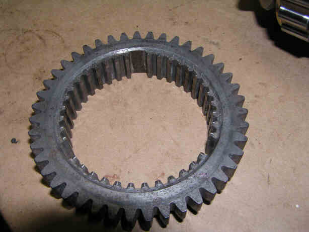

I got this slider used and it is in really good shape. The teeth are sharp and there is ver little wear

DNHunt   I got this slider used and it is in really good sh...   Nov 6 2005, 08:12 AM
DNHunt   The slider goes on with the teeth facing the first...   Nov 6 2005, 08:13 AM
