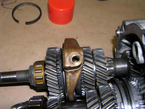

DNHunt   Shift forks, shafts and detents. I really like thi...   Nov 6 2005, 12:33 PM
DNHunt   Start with the 4th, 5th shift fork on it's sli...   Nov 6 2005, 12:35 PM
DNHunt   Next I inserted it's shift rod.   Nov 6 2005, 12:37 PM
DNHunt   Then I added the ball that is part of the detent i...   Nov 6 2005, 12:39 PM
DNHunt   All these balls, springs, and rods go in this hole...   Nov 6 2005, 12:43 PM
DNHunt   Next comes a spring with the little rod inside it....   Nov 6 2005, 12:44 PM

DNHunt   Next I put the 2nd, 3rd shift fork on its' sli...   Nov 6 2005, 12:50 PM
DNHunt   Next, 2nd, 3rd shift rod! These bolts are only...   Nov 6 2005, 12:52 PM
