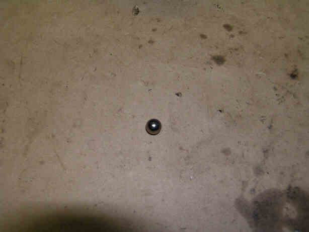

Then I added the ball that is part of the detent in the tube.

DNHunt   Then I added the ball that is part of the detent i...   Nov 6 2005, 12:39 PM
