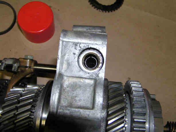

All these balls, springs, and rods go in this hole in the intermediate plate. Beware the balls can come out of the holes that the shift rods pass through. All purpose grease is tacky enough to slow them down. I had to get down on my hands and knees to find one of the little suckers.

DNHunt   All these balls, springs, and rods go in this hole...   Nov 6 2005, 12:43 PM
DNHunt   Next comes a spring with the little rod inside it....   Nov 6 2005, 12:44 PM
