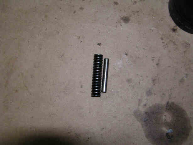

Next comes a spring with the little rod inside it. Again grease.

DNHunt   Next comes a spring with the little rod inside it....   Nov 6 2005, 12:44 PM
Aaron Cox   as joe sharp said yesterday - the ball and stick g...   Nov 6 2005, 12:46 PM
