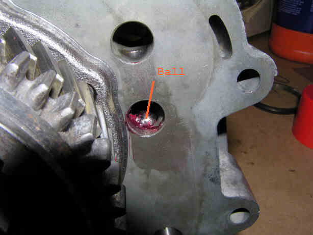

DNHunt   All these balls, springs, and rods go in this hole...   Nov 6 2005, 12:43 PM
DNHunt   Next comes a spring with the little rod inside it....   Nov 6 2005, 12:44 PM
Aaron Cox   as joe sharp said yesterday - the ball and stick g...   Nov 6 2005, 12:46 PM
DNHunt   Then comes the second ball. You shoud be able to s...   Nov 6 2005, 12:48 PM
